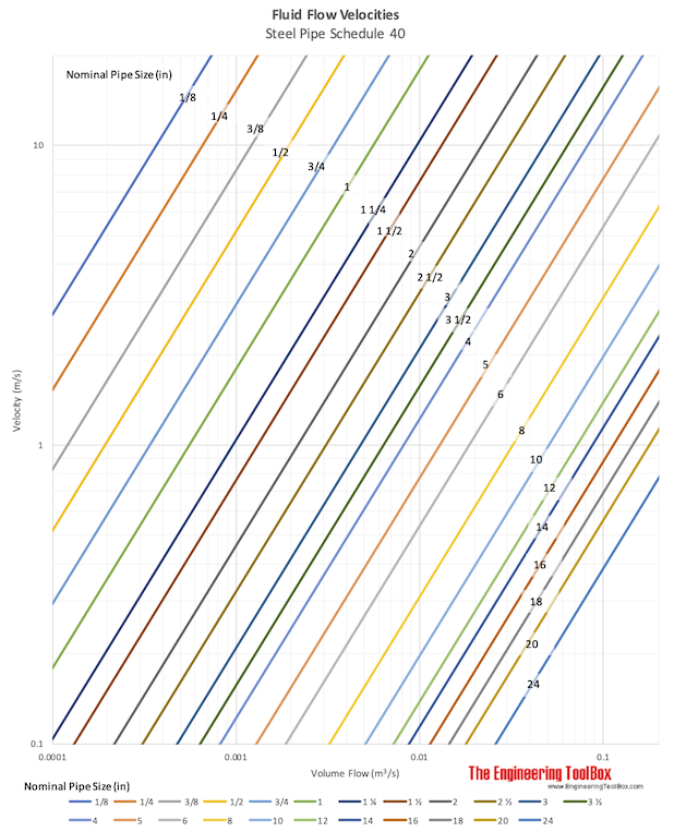

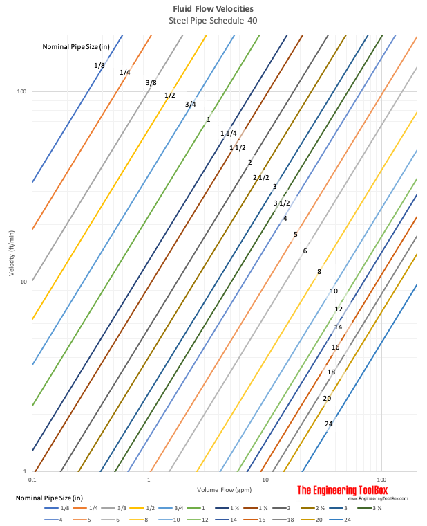

Flow velocities in steel pipe schedule 40

Flow velocities in steel pipe schedule 40 metric units
