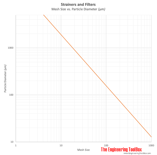

Mesh size vs particle diameter
Download and print Particle Diameter vs. Mesh Size Chart
