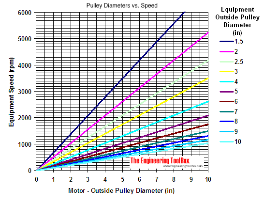

Motor 1050 rpm
Motor equipment belt pulley 1050 rpm speed

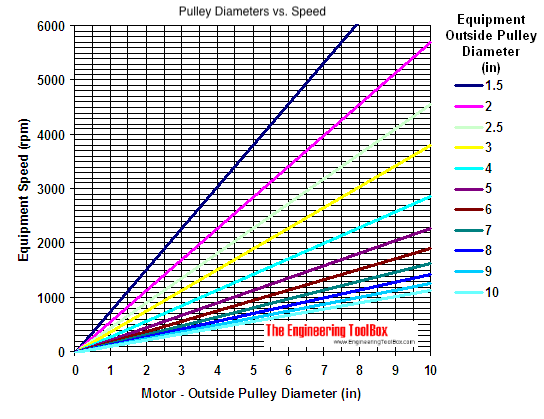

Motor 1140 rpm
Motor equipment belt pulley 1140 rpm speed

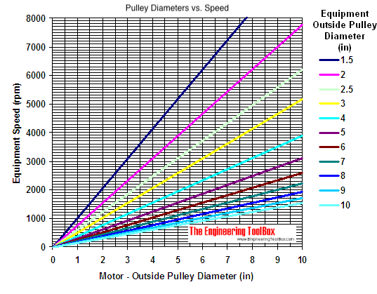

Motor 1550 rpm
Motor equipment belt pulley 1550 rpm speed

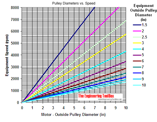

Motor 1725 rpm
Motor equipment belt pulley 1725 rpm speed

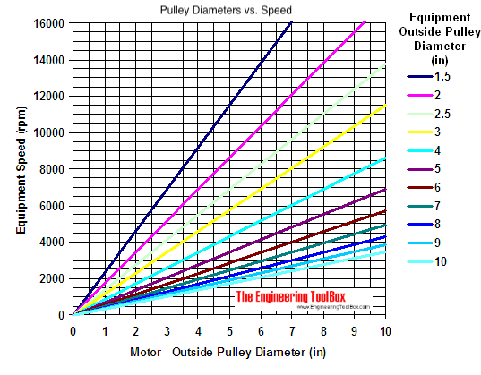

Motor 3450 rpm
Motor equipment belt pulley 3450 rpm speed
