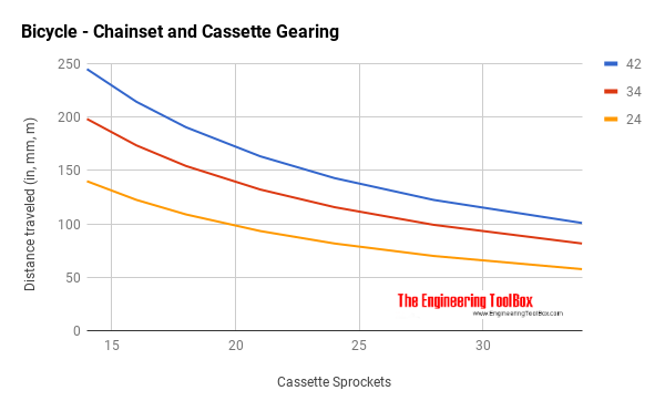

Example - Bicycle Gear
A mountain bike with 26 inch outer diameter wheels has a 42/34/24T chain-set and a 7-speed 14-34 cassette in the rear wheel.
The outer circumference of the wheel can be calculated as
c = π (26 in)
= 81.7 in
The distance traveled by the wheel in the lowest gear - for one pedaling revolution - using the smallest sprocket in the chainset (24T) and the largest sprocket in the cassette (34T) - can be calculated using (3b) as
l = (1) (81.6 in) (24) / (34)
= 57.7 in
The distance traveled by the wheel in the highest gear - for one pedaling revolution - using the largest sprocket in the chainset (42T) and the smallest sprocket in the cassette (14T) - can be calculated as
l = (1) (81.6 in) (42) / (14)
= 244.8 in
Bicycle Gearing Calculator
Calculate distance traveled by wheel.
The calculator is generic and can be used for SI and Imperial units - output units equals input units.
bicycle wheel outside diameter - d - (m, mm, in)
number of teeth in chain-set sprocket
number of teeth in cassette sprocket
Bicycle Gearing Calculator - Template
Make your own graphical Bicycle Gearing Calculator by using this Google Docs template!
Bicycle - chainset cassette sprockets wheel size gearing
