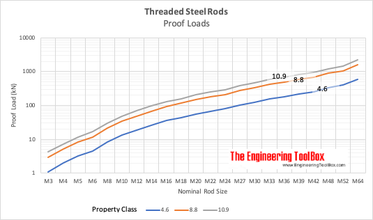

Proof load capacities of metric threaded steel rods.
Threaded hanger rod
Metric threaded steel rods - typical minimum proof load:

Threaded rods - proof loads - kN
Threaded steel rods are typically used as hangers in piping, HVAC and electrical systems.
