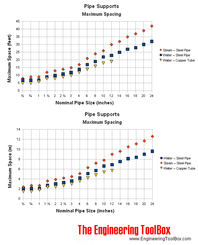

Recommended maximum support span between hangers - and rod sizes for straight horizontal pipes.
Recommended maximum space between hangers for straight horizontal pipes and tubes are indicated in the table below. The values does not apply where loads are concentrated with flanges, valves, specialties, etc. A common rule of thumb is to support loads of this type with hangers on both sides of the load.

Pipe support - maximum spacing  diagram
