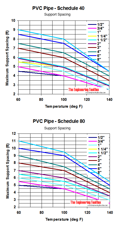

PVC Pipes
PVC pipes - temperature and maximum support spacing diagram
  • 1 ft (foot) = 0.3048 m
  • T(oF) = (T(oC))(9/5) + 32

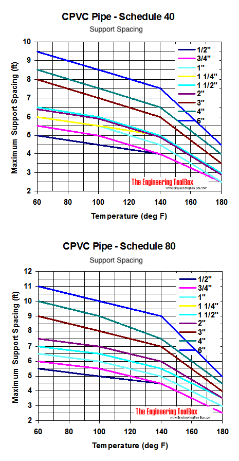

CPVC Pipes
CPVC pipes, temperature and maximum support spacing diagram

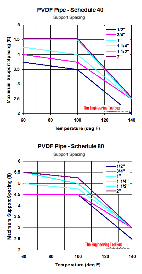

PVDF Pipes
PVDF pipes, temperature and maximum support spacing diagram

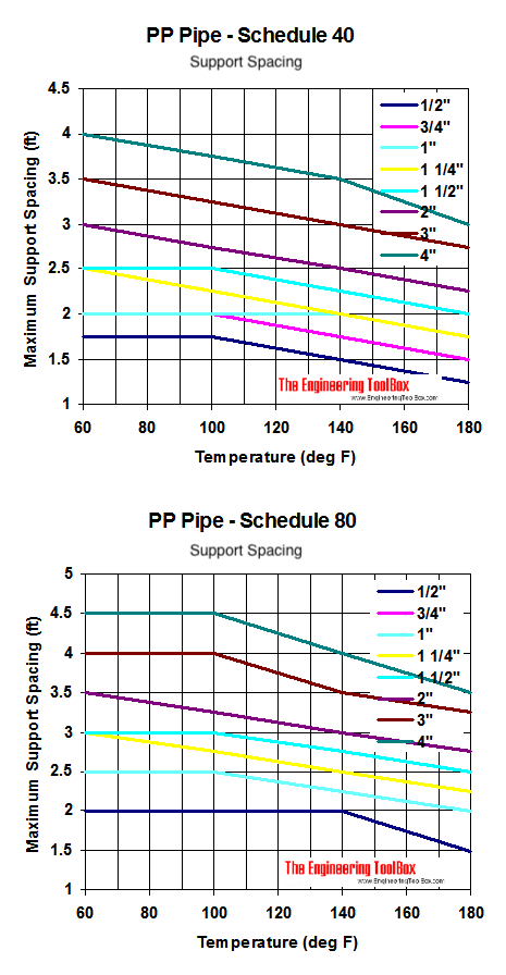

PP Pipes
PP pipes, temperature and maximum support spacing diagram
