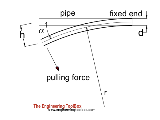

Radius and Angle vs. Deflection when bending Pipe
The radius of the bending pipe can be hard to measure in field. In practice a rope or chain may be tied to the end of the pipe and the end is pulled until deflection is achieved.
Deflection for a given radius and length of deflecting pipe can be calculated as
h = l2 / (2 r)                       (3)
h = deflection of pipe (m, in)
r = radius of bending pipe (m, in)
l = length of pipe from fixed position (m, in)
Eq. 3 can be modified with eq. 2 to calculate maximum deflection for minimum radius to
hmax = l2 / (60 d)                     (3b)
hmax = deflection at minimum radius (m)
The angle can be calculated as
α = l 180 / (π r)                  (4)
α = angle (degrees)
Eq. 4 can be modified with eq. 2 to calculate the maximum angle at minimum radius as
αmax = l 60 / (π d)                  (4b)
