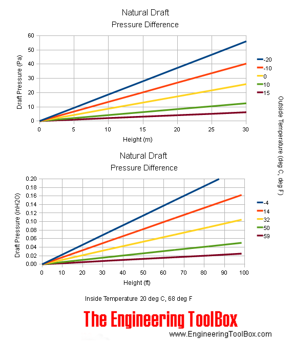

Natural Draft Head
The natural draft head can be calculated as
dhmmH2O = 1000 h (ρo - ρr) / ρh2o                   (1)

Natural Draft Pressure
Equation (1) can be modified to SI pressure units:
dp = g ( ρo - ρr) h                                   (1b)
d p = pressure (Pa, N/m2)
g = acceleration of gravity - 9.81 (m/s2)

Natural Draft Chart - SI and Imperial Units
Natural draft chart - imperial and metric units
