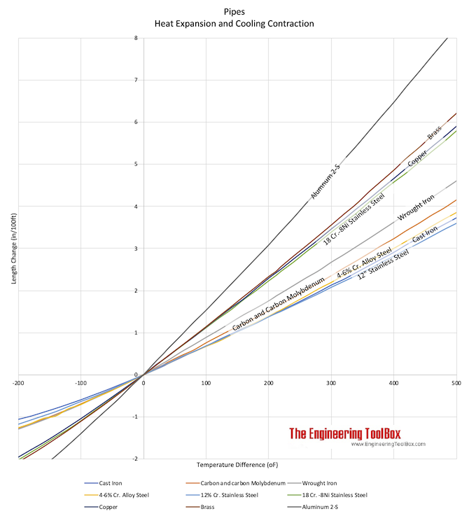

Piping Materials - Temperature Heat Expansion and Cooling Contraction
Expansion and contraction when cast iron, carbon and carbon molybdenum steel, wrought iron, copper, brass and aluminum pipes are heated or cooled.
Temperature expansion of pipes or tubes with some commonly used materials:
For full table with wrought iron, stainless steel, copper, brass and aluminum - rotate the screen!
