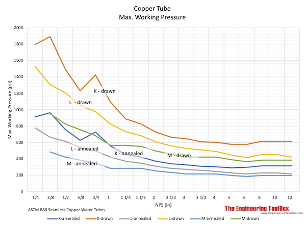

Copper Tubes Type K, L and M - Working Pressures vs. Size
ASTM B88 seamless copper water tubes - working pressures.
Working pressure of copper tubes type K, L and M are indicated in the table below.
Ratings based on service temperature max. 150 oF (66 oC).
- yield strength S = 5100 psi (35 MPa) for annealed
- yield strength S = 10000 psi (69 MPa) for drawn tube
Copper tube - Type K
| Nominal Size (in) | Working Pressure (psi) | Actual Burst Pressure (psi) | ||
| Annealed | Drawn | Annealed | Drawn | |
| 1/4 | 913 | 1796 | ||
| 3/8 | 960 | 1889 | ||
| 1/2 | 758 | 1490 | 4535 | 9840 |
| 5/8 | 626 | 1229 | ||
| 3/4 | 724 | 1424 | 4200 | 9300 |
| 1 | 557 | 1093 | 3415 | 7200 |
| 1 1/4 | 452 | 888 | 2800 | 5525 |
| 1 1/2 | 420 | 825 | 2600 | 5000 |
| 2 | 370 | 726 | 2235 | 3915 |
| 2 1/2 | 338 | 664 | 3575 | |
| 3 | 328 | 643 | 3450 | |
| 3 1/2 | 311 | 610 | ||
| 4 | 306 | 600 | 3415 | |
| 5 | 293 | 575 | 3585 | |
| 6 | 295 | 578 | 3425 | |
| 8 | 314 | 615 | 3635 | |
| 10 | 314 | 615 | ||
| 12 | 314 | 615 | ||
Copper tube - Type L
| 1/4 | 775 | 1524 | ||
| 3/8 | 662 | 1302 | ||
| 1/2 | 613 | 1206 | 3885 | 7765 |
| 5/8 | 537 | 1055 | ||
| 3/4 | 495 | 972 | 2935 | 5900 |
| 1 | 420 | 825 | 2650 | 5115 |
| 1 1/4 | 373 | 733 | 2400 | 4550 |
| 1 1/2 | 347 | 682 | 2200 | 4100 |
| 2 | 309 | 607 | 1910 | 3365 |
| 2 1/2 | 285 | 560 | 3215 | |
| 3 | 270 | 529 | 2865 | |
| 3 1/2 | 258 | 506 | ||
| 4 | 249 | 489 | 2865 | |
| 5 | 229 | 449 | 2985 | |
| 6 | 213 | 418 | 2690 | |
| 8 | 230 | 451 | 2650 | |
| 10 | 231 | 452 | ||
| 12 | 215 | 423 | ||
Copper tube - Type M
| 3/8 | 485 | 953 | ||
| 1/2 | 420 | 825 | 6135 | |
| 3/4 | 346 | 680 | 4715 | |
| 1 | 286 | 563 | 3865 | |
| 1 1/4 | 287 | 565 | 3875 | |
| 1 1/2 | 282 | 553 | 3550 | |
| 2 | 254 | 499 | 2935 | |
| 2 1/2 | 233 | 457 | 2800 | |
| 3 | 215 | 423 | 2665 | |
| 3 1/2 | 214 | 421 | ||
| 4 | 213 | 419 | 2215 | |
| 5 | 198 | 388 | 2490 | |
| 6 | 186 | 364 | 2000 | |
| 8 | 195 | 382 | 2285 | |
| 10 | 195 | 383 | ||
| 12 | 195 | 383 | ||
