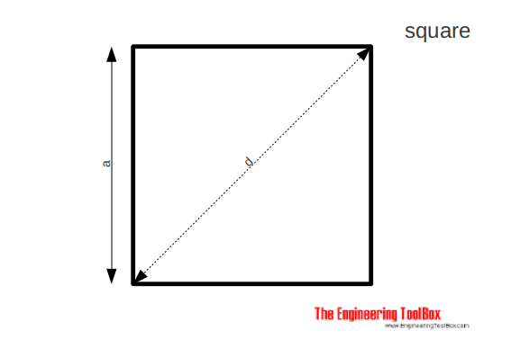

Square
Square - area, side, diagonal
The area of a square can be calculated as
A = a2                            (1a)
The side of a square can be calculated as
a = A1/2                            (1b)
The diagonal of a square can be calculated as
d = a 21/2                        (1c)

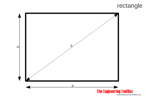

Rectangle
Rectangle - area, diagonal
The area of a rectangle can be calculated as
A = a b          (2a)
The diagonal of a rectangle can be calculated as
d = (a2 + b2)1/2     (2b)

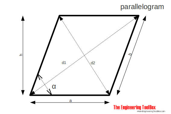

Parallelogram
Parallelogram - area and diagonals
The area of a parallelogram can be calculated as
A = a h
  = a b sin α                        (3a)
The diameters of a parallelogram can be calculated as
d1 = ((a + h cot α)2 + h2)1/2                      (3b)
d2 = ((a - h cot α)2 + h2)1/2                     (3b)

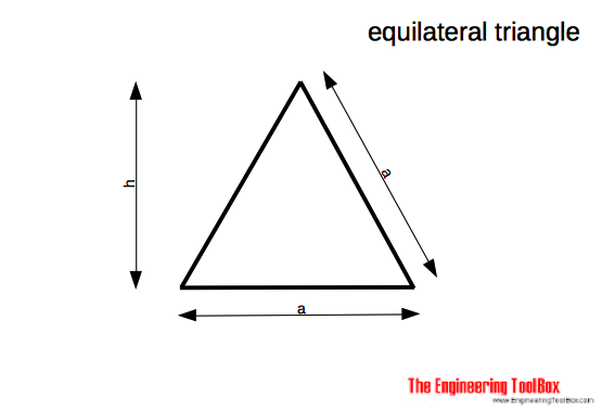

Equilateral Triangle
An equilateral triangle is a triangle in which all three sides are equal.
Equilateral triangle - area and height
The area of an equilateral triangle can be calculated as
A = a2/3 31/2                                 (4a)
h = a/2 31/2                              (4b)

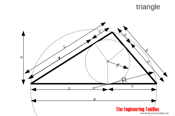

Triangle
Triangle - area, height, radius
The area of a triangle can be calculated as
A = a h / 2
  = r s                                 (5a)
r = a h / 2s                          (5b)
R = b c / 2 h                        (5c)
s = (a + b + c) / 2                     (5d)
x = s - a                           (5e)
y = s - b                           (5f)
z = s - c                          (5g)

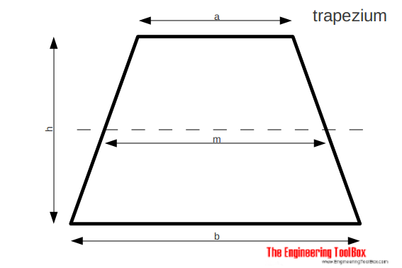

Trapezoid
Trapezium - trapezoid - area, height
The area of a trapezoid can be calculated as
A = 1/2 (a + b) h
  = m h                           (6a)
m = (a + b) / 2                      (6b)

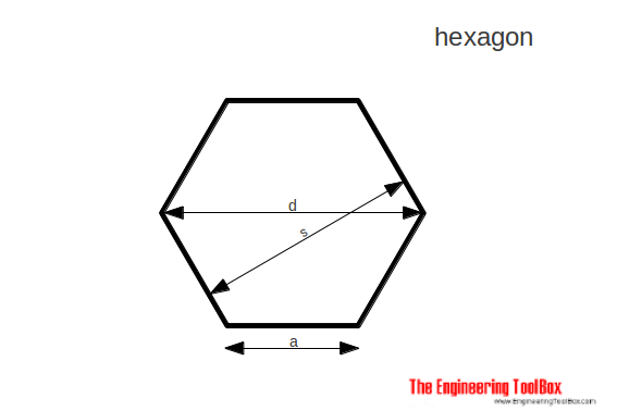

Hexagon
Hexagon - area, diameter
The area of a hexagon can be calculated as
A = 3/2 a2 31/2                             (7a)
d = 2 a
  =  2 / 31/2
  = 1.1547005 s                              (7b)
s = 31/2 / 2 d
   = 0.866025 d                              (7c)

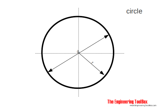

Circle
Crcle - area
The area of a circle can be calculated as
A = π/4 d2
  = π r2
  = 0.785.. d2                       (8a)
C = 2 π r
  =  π d                           (8b)
C = circumference
