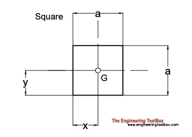

Square
centroid square
Distance
x = a / 2              (1a)
y = a / 2              (1b)
Area
A = a2              (1c)

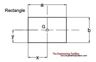

Rectangle
centroid rectangle
Distance
x = a / 2              (2a)
y = b / 2              (2b)
Area
A = a b              (2c)

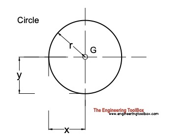

Circle
centroid circle
Distance
x = r              (3a)
y = r              (3b)
Area
A = π r2              (3c)

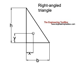

Right-angled Triangle
centroid right-angled triangle
Distance
x = b / 3              (5a)
y = h / 3              (5b)
Area
A = b h / 2             (5c)
