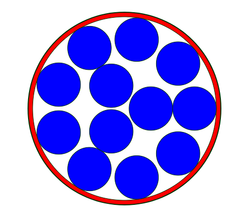

The calculator below can be used to estimate the maximum number of small circles that fits into an outer larger circle. The calculator can be used to calculate applications like
  • the number of small pipes that fits into a large pipe or tube
  • the number of wires possible in a conduit
  • the number of fibers that fits in a connector
  • and similar applications
Input
  • the inside diameter of an outer larger circle (or pipe, tube, conduit, connector), and
  • the outside diameters of small circles (or pipes, wires, fiber)
The default values are for a 10 inch pipe with 2 inch smaller pipes - dimensions according ANSI Schedule 40 Steel Pipes.
  • Note that the algorithm is quite simple - a circle or more may be added by rearranging the circles in a more sophisticated pattern.
