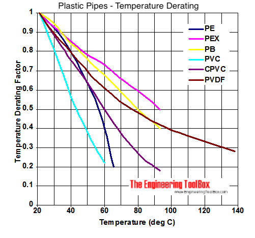

Plastic Pipes Operating Temperatures
Typical maximum operating temperatures for common plastic pipe materials are indicated below. Note that working pressure varies with type of material and schedule (wall thickness).
