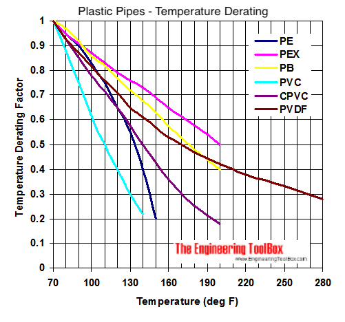

Increased temperatures derates the strength of thermoplastic piping materials.
Thermoplastic materials loose strength to pressure and tension with increasing temperature. The table below can be used as a guide to common thermoplastics and their derated strength with temperature. Manufacturing data should always be consulted.

Plastic Pipes Temperature Derating Diagram
Thermoplastic pipes - temperature and strength and stiffnes diagram
Example - Higher Temperature and Reduced Strength
If the operating pressure for a 6" Schedule 80 CPVC pipe is 167 psi, the maximum operating pressure at 150 oF (66 oC) is reduced to
(167 psi) 0.5
    = 83.5 psi
