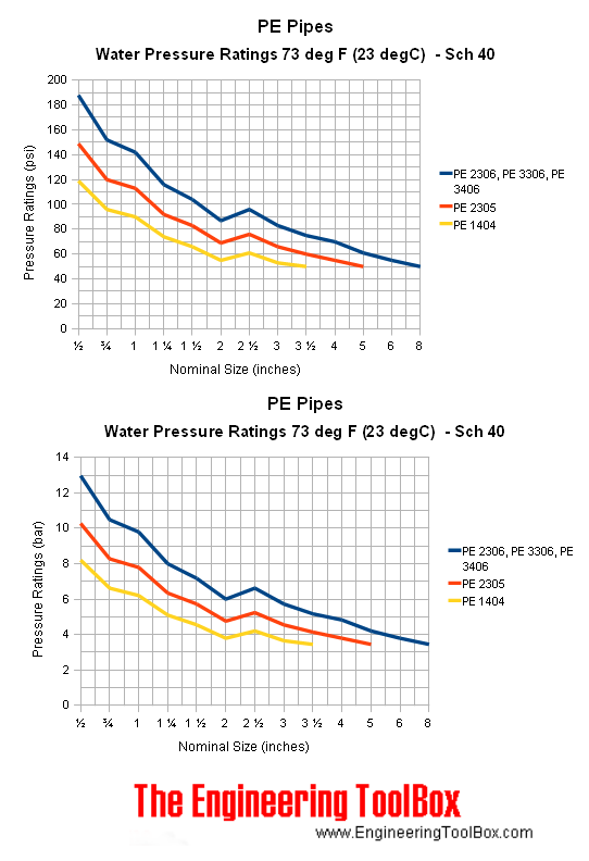

PE Pipes - Schedule 40
PE pipes schedule 40 - pressure ratings

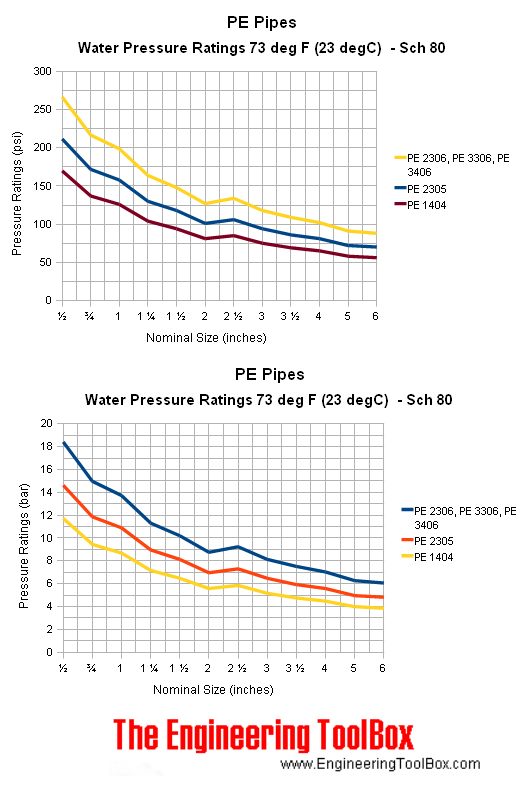

PE Pipes - Schedule 80
PE pipes schedule 80 - pressure ratings
