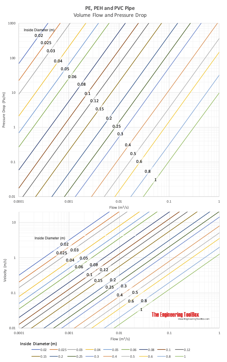

Pressure loss (bar/100 m) and velocy in PE, PEH or PVC pipes with water flow.
Pressure drop in PE, PEH or PVC plastic pipes or tubes:
PE, PEH and PVC pipes - pressure drop diagram

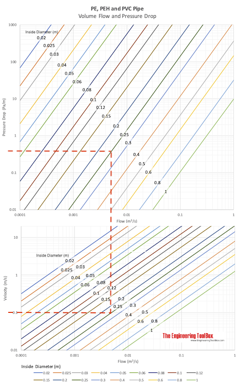

Example - pressure drop in a PEH pipe
Pressure drop in a PEH pipe with inside diameter 250 mm (0.25 m) and water flow 50 l/s (0.005 m3/s) can be estimated to be approximately 0.35 Pa/m (0.035 bar/100 m) as indicated in the diagram below. The flow velocity is approximately 1 m/s.
PE, PEH and PVC pipes - pressure drop diagram - example
