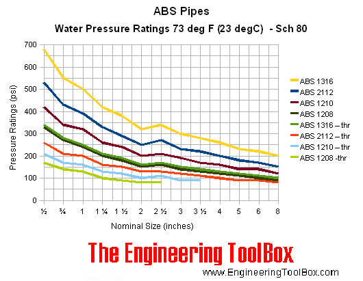

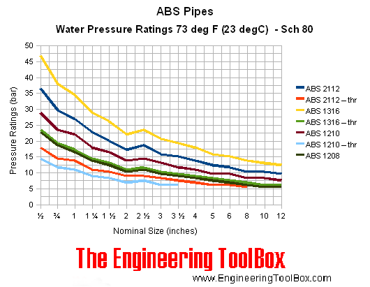

ABS Pipes - Schedule 80
Pressure psi
ABS pipes - pressure ratings  - schedule 80 - psi
Pressure bar
ABS pipes - pressure ratings - schedule 80 - bar
  • thr - threaded pipe
