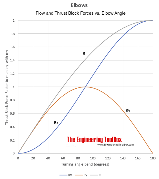

The resultant force - or required support force - on a thrust block - or an anchor - for a bend depends on
  • the fluid mass flow, or flow velocity
  • the change of flow direction
  • the internal pressure
With no flow and no pressure there is no force.

Resulting force due to Mass flow and Flow Velocity
The resulting force in x-direction due to mass flow and flow velocity can be expressed as:
Rx = m v (1 - cos(β))                          (1)
    = ρ A v2 (1 - cos(β))                            (1b)
    = ρ π (d / 2)2 v2 (1 - cos(β))                           (1c)
Rx = resulting force in x-direction (N)
m = mass flow (kg/s)
v = flow velocity (m/s)
β = turning bend angle (degrees)
ρ = fluid density (kg/m3)
d = internal pipe or bend diameter (m)
π = 3.14...
The resulting force in y-direction due to mass flow and flow velocity can be expressed as:
Ry = m v sin(β)                            (2)
    = ρ A v2 sin(β)                            (2b)
    = ρ π (d / 2)2 v2 sin(β)                           (2c)
Ry = resulting force in y direction (N)
The resulting force on the bend due to force in x- and y-direction can be expressed as:
R = (Rx2 + Ry2)1/2                            (3)
R = resulting force on the bend (N)
Elbows - fluid flow and thrust block force
Example - Resulting force on a bend due to mass flow and flow velocity
The resulting force on a 45o bend with
  • internal diameter 102 mm = 0.102 m
  • water with density 1000 kg/m3
  • flow velocity 20 m/s
can be calculated by as
Resulting force in x-direction:
Rx = (1000 kg/m3) π ((0.102 m) / 2)2 (20 m/s)2 (1 - cos(45))
    = 957 N
Resulting force in y-direction:
Ry = (1000 kg/m3) π ((0.102 m) / 2)2 (20 m/s)2 sin(45)
    = 2311 N
Resulting force on the bend
R = (957 N)2 + (2311 N)2)1/2
    = 2501 N
Note - if β is 90othe resulting forces in x- and y-directions are the same.
