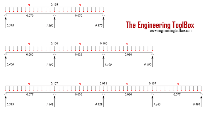

Continuous Beam with Distributed Load
continuous beam moment reaction support forces distributed loads
For a continuous beam with 3, 4 or 5 supports and distributed load the reaction support forces can be calculated as
R = cr q L                     (1)
R = reaction support force (N, lbf)
cr = reaction support force coefficient from the figure above
q = distributed load (N/m, lbf/ft)
L = span length (m, ft)
The moments can be calculated as
M = cm q L2                     (2)
M = beam moment (Nm, lbf ft)
cm = moment coefficient from the figure above
Example - Continuous Beam with Distributed Load
The reaction forces in the end supports for a continuous beam with 3 supports and distributed load 1000 N/m can be calculated as
Rend = (0.375) (1000 N/m)
         = 375 N
         = 0.38 kN
The reaction force in the center support can be calculated as
Rcenter = (1.250) (1000 N/m)
         = 1250 N
         = 1.25 kN
The beam moments at the middle of spans with span length 1m can be calculated as
Mend = (0.070) (1000 N/m) (1 m)2
        = 70 Nm
The beam moment at the center support can be calculated as
Mcenter = (0.125) (1000 N/m) (1 m)2
        = 125 Nm

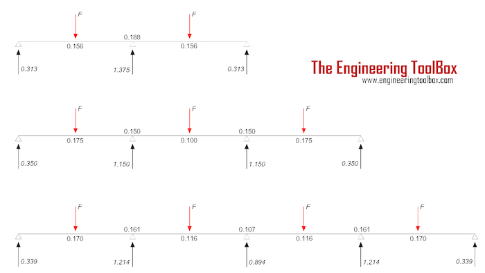

Continuous Beam with Point Loads
continuous beam moment reaction support forces point loads
For a continuous beam with 3, 4 or 5 supports and point loads the reaction support forces can be calculated as
R = cr F                      (3)
F = point load (N, lbf)
M = cm F L                     (4)
Example - Continuous Beam with Point Loads
The reaction forces in the end supports for a continuous beam with 3 supports and 2 point loads 1000 N can be calculated as
Rend = (0.313) (1000 N)
         = 313 N
         = 0.31 kN
Rcenter = (1.375) (1000 N)
         = 1375 N
         = 1.4 kN
The beam moments at point loads with span length 1m can be calculated as
Mend = (0.156) (1000 N) (1 m)
        = 156 Nm
Mcenter = (0.188) (1000 N) (1 m)
        = 188 Nm
