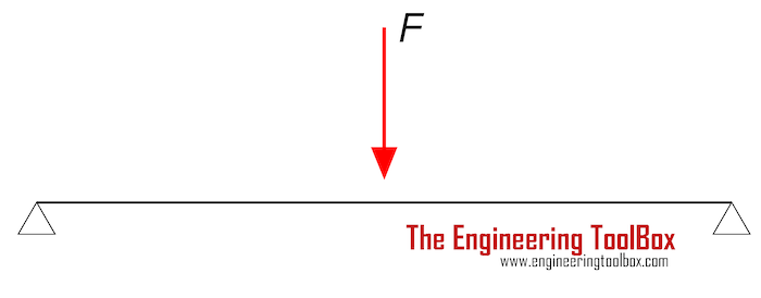

Simply Supported Structure - Mass Concentrated in the Center
Vibration - simply supported structure - mass concentrated in the center
For a simply supported structure with the mass - or load due to gravitational force weight - acting in the center, the natural frequency can be estimated as
f = (1 / (2 π)) (48 E I / M L3)0.5                                    (3)
M = concentrated mass (kg)

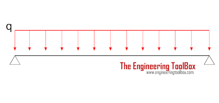

Simply Supported Structure - Sagging with Distributed Mass
Vibration - simply supported structure - sagging with mass distributed
For a simply sagging supported structure with distributed mass - or load due to gravitational force - can be estimated as
f = (π / 2) (E I / q L4)0.5                                 (4)
Example - Natural Frequency of Beam
The natural frequency of an unloaded (only its own weight - dead load) 12 m long DIN 1025 I 200 steel beam with Moment of Inertia 2140 cm4 (2140×10-8 m4) and Modulus of Elasticity 200×109 N/m2 and mass 26.2 kg/m can be calculated as
f = (π / 2) ((200×109 N/m2) (2140×10-8 m4) / (26.2 kg/m) (12 m)4)0.5
= 4.4 Hz  - vibrations are likely to occur
The natural frequency of the same beam shortened to 10 m can be calculated as
f = (π / 2) ((200×109 N/m2) (2140×10-8 m4) / (26.2 kg/m) (10 m)4)0.5
= 6.3 Hz  - vibrations are not likely to occur

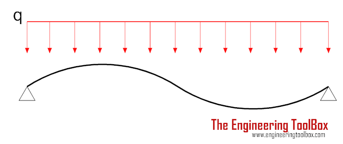

Simply Supported Structure - Contraflexure with Distributed Mass
Vibration - simply supported structure - contraflexure with mass distributed
For a simply contraflexure supported structure with distributed mass - or dead load due to gravitational force - can be estimated as
f = 2 π (E I / q L4)0.5                                      (5)

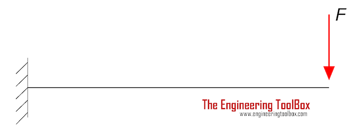

Cantilever with Mass Concentrated at the End
Vibration - cantilever structure - mass concentrated at the end
For a cantilever structure with the mass - or dead load due to gravitational force - concentrated at the end, the natural frequency can be estimated as
f = (1 / (2 π)) (3 E I / F L3)0.5                              (6)

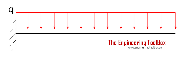

Cantilever with Distributed Mass
Vibration - cantilever structure - mass distributed
For a cantilever structure with distributed mass - or dead load due to gravitational force - the natural frequency can be estimated as
f = 0.56 (E I / q L4)0.5                                    (7)

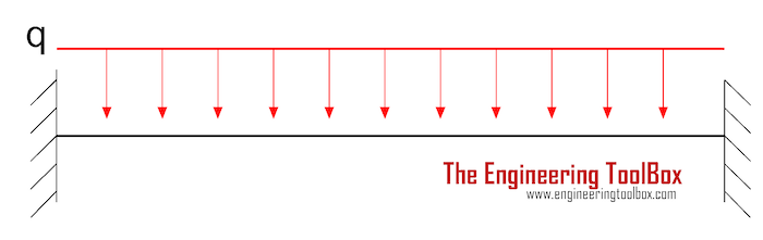

Structure with Fixed Ends and Distributed Mass
Vibration - structure with fixed ends - mass distributed
For a structure with fixed ends and distributed mass - or dead load due to gravitational force - the natural frequency can be estimated as
f = 3.56 (E I / q L4)0.5                          (8)
