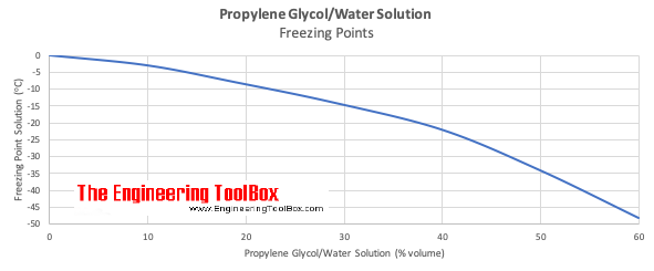

Freezing Points of Propylene Glycol based Water Solutions
Freezing point of propylene glycol based water solutions at different temperatures:
Propylene Glycol based Heat-Transfer Fluids - Freezing Points
Propylene Glycol Solution
by mass 0 10 20 30 40 50 60
by volume 0 10 19 29 40 50 60
Freezing Points oF 32 26 18 7 -8 -29 -55
oC 0 -3 -8 -14 -22 -34 -48
Due to slush creation - a propylene glycol and water solution should not be used close to freezing points.
Propylene glycol water solutions - freezing points

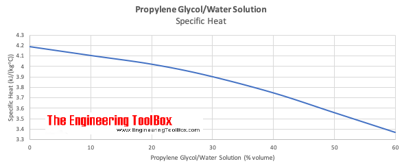

Specific Heats of Propylene Glycol Solutions
Specific heat of propylene glycol solutions:
Propylene Glycol based Heat-Transfer Fluids - Specific Heats
by volume 0 10 20 29 40 50 60
Specific Heat
- cp -
(Btu/lb oF)
1.000 0.980 0.960 0.935 0.895 0.850 0.805
  • 1 Btu/(lbmoF) = 4186.8 J/(kg K) = 1 kcal/(kgoC)
Propylene glycol water solutions - specific heat
