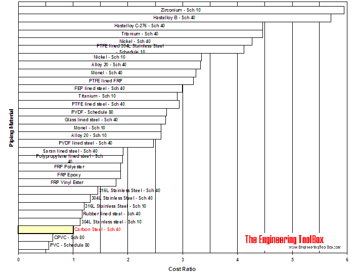

Piping Materials - Cost Ratios
Installing cost ratios for piping materials related to carbon steel pipes.
Installation cost ratios of common piping materials as
  • Alloy 20
  • Carbon steel (reference = 1)
  • CPVC
  • FEP lined steel
  • Stainless steel 316L
  • FRP - Vinyl ester
  • FRP - Epoxy
  • FRP - Polyester
  • Glass lined steel
  • Hastelloy
  • Monel
  • Nickel
  • Polypropylene lined steel
  • PTFE lined FRP
  • PTFE lined steel
  • PTFE lined 304L Stainless steel
  • PVC
  • PVDF
  • Rubber lined carbon steel
  • Saran lined steel
  • Stainless steel 304L
  • Titanium
  • Zirconium
related to pipes in carbon steel are indicated in the chart below:
Piping - materials costs ratio
  • PTFE - PolyTetraFluoroEthylene
  • FRP - fibreglass
  • PVDF - PolyVinyliDene Fluoride
  • FEP - Fluorinated Ethylene Propylene
Installed cost ratios are based on a 100 m (400 ft) DN 50 (2") pipe installation.
