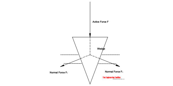

Forces Acting on a Wedge
Large forces can be introduced with the aid of wedges.
With a wedge a small force can be translated into large forces.

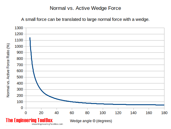

wedge - normal forces vs avtual force
The normal forces can be calculated as
FN = F / (2 sin(Θ / 2)                              (1)
FN = normal force (N)
F = acting force (N)
Θ = wedge angle (degrees)
Wedge Force Calculator
Wedge Normal vs. Aktive Force Ratio
Wedge - Normal vs. Aktive Force Ratio
