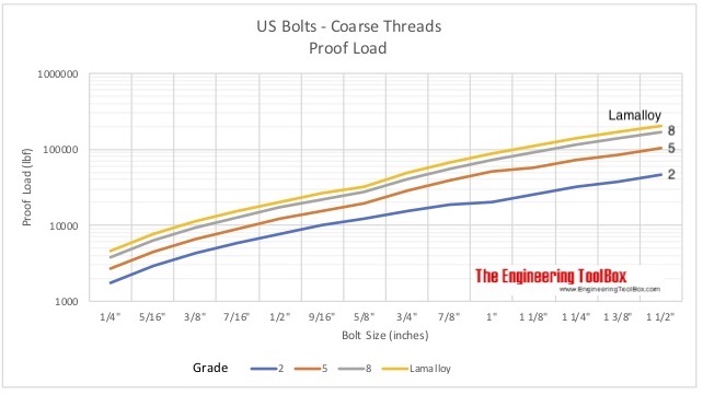

U.S. Bolts - Coarse Threads
Proof Load
| Nom Bolt Size (in) | Grade | |||
| 2 | 5 | 8 | Lamalloy | |
| Proof Load (lbf) | ||||
| 1/4 | 1750 | 2700 | 3800 | 4600 |
| 5/16 | 2900 | 4450 | 6300 | 7600 |
| 3/8 | 4250 | 6600 | 9300 | 11250 |
| 7/16 | 5850 | 9050 | 12800 | 15400 |
| 1/2 | 7800 | 12100 | 17000 | 20600 |
| 9/16 | 10000 | 15500 | 21800 | 26400 |
| 5/8 | 12400 | 19200 | 27100 | 32750 |
| 3/4 | 18400 | 28400 | 40100 | 48500 |
| 7/8 | 15200 | 39300 | 55400 | 67000 |
| 1 | 20000 | 51500 | 72700 | 87900 |
| 1 1/8 | 25200 | 56500 | 91600 | 110700 |
| 1 1/4 | 32000 | 71700 | 116300 | 140500 |
| 1 3/8 | 38100 | 85500 | 138600 | 167500 |
| 1 1/2 | 46400 | 104000 | 168600 | 203700 |
