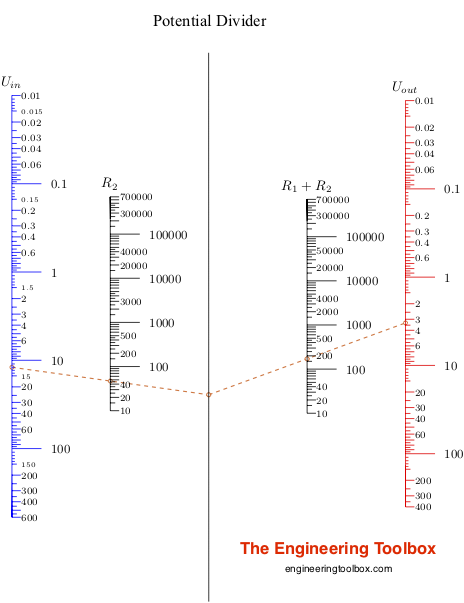

Potential Divider Nomogram
The nomogram below can be used to estimate a potential divider.
Potential divider Nomogram - Input and output voltage - resistances  Download and print the Potential Divider Nomogram!
The default values in the nomogram above are for Uin = 12 VR2 = 47 ohm and Uout3.3 V. Since the sum of the resistances (R1 + R2) according the nomogram is approximately 170 ohm - the resistance R1 can be calculated as
R1 ≈ (170 ohm - 47 ohm)
    ≈ 123 ohm.
