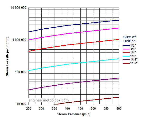

Steam Leaks through Orifices
Steam leaks through orifices for pressures ranging 250 - 600 psi
Steam lost (lb per month) trough orifice leaks - orifices ranging size 1/16" to 1/2":
steam leaks through orifices diagram
  • 1 lb = 0.4536 kg
  • 1 psi (lb/in2) = 6,894.8 Pa (N/m2) = 6.895×10-2 bar
