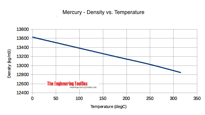

Mercury - Density vs Temperature
Mercury - Density vs. temperature diagram

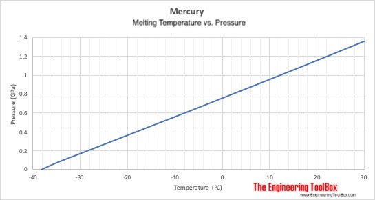

Mercury - Melting Curve - Temperature vs. Pressure
Mercury - melting curve - temperature vs. pressure
