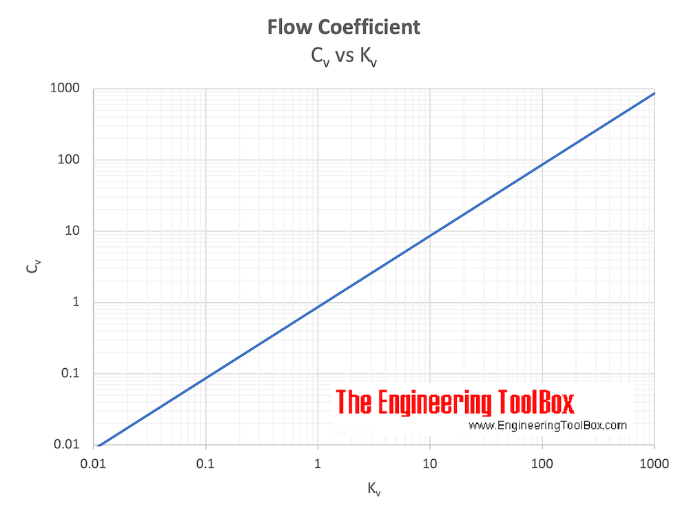

Converting between Flow Coefficient Cv and Flow Factor Kv
The relationship between Cv and Kv can be expressed as:
Cv = 1.16 Kv                            (1)
Kv = 0.862 Cv                          (2)
Flow coefficient - Cv vs. Kv
Download and print Flow Coefficient - Cv vs. Kv chart
