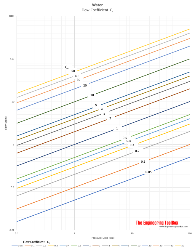

The flow coefficient Cv for a water control valve can be estimated with the diagram below:
Water valves - Cv diagram

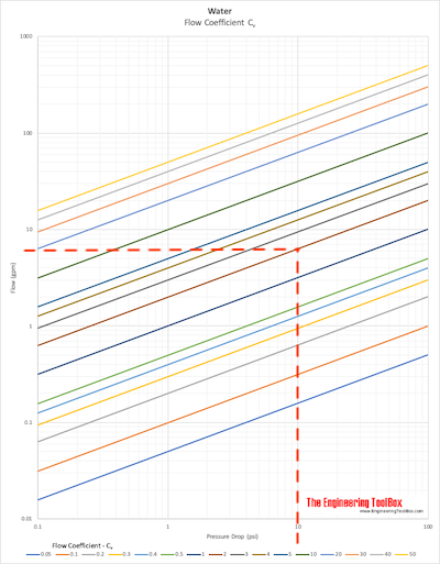

Example - Required Cv for a water control valve
With water flow 6 gpm and designed pressure drop 10 psi through a control valve - the required flow coefficient Cv can be estimated to ~2 as indicated in the chart below.
Water valves - Cv diagram example
