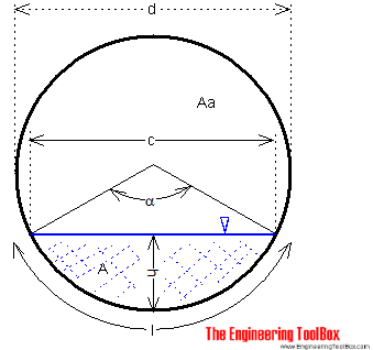

Horizontal circular tank - volume content
An iterative algorithm is used for the calculation - adding smal sliced volumes slice by slice as indicated in the figure above.
The calculator outputs
  • the liquid volume in the tank
  • the liquid mass
  • the central angle
  • the chord length
  • the arc length
  • the cross sectional area of both liquid and air
  • the air volume in the tank

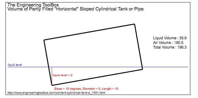

Side-view of the Cylindrical Tank or Pipe
The figure redraws when the parameters in the calculator are changed and calculated.
Volume of tilted tank or cylinder

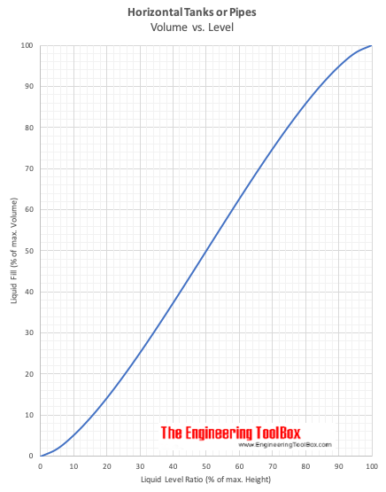

Liquid Level and Volume in a Horizontal Tank or Pipe
The chart below can be used for horizontal tanks or pipes where the slope is zero.
Horizontal Tank - liquid level and volume fill - chart
Liquid Level ratio (% of max height) 0 5 10 15 20 25 30 35 40 45 50 55 60 65 70 75 80 85 90 95 100
Liquid Fill (% of max volume) 0 2 5 9 14 20 25 31 37 44 50 56 63 69 75 80 86 91 95 98 100
