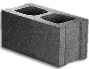

Masonry Blocks - Dimensions
Concrete Masonry Unit Blocks (CMU) - dimensions.
concrete masonry block
Typical Concrete Masonry Units - CMU - dimensions
Standard Blocks
Masonry Standard Block Dimensions
Nominal Size
(in)
Actual Size
(in)
4 x 8 x 16 3-5/8 x 7-5/8 x 15-5/8
6 x 8 x 16 5-5/8 x 7-5/8 x 15-5/8
8 x 8 x 16 7-5/8 x 7-5/8 x 15-5/8
10 x 8 x 16 9-5/8 x 7-5/8 x 15-5/8
12 x 8 x 16 11-5/8 x 7-5/8 x 15-5/8
Half Blocks
Masonry Half Block Dimensions
Nominal Size
(in)
Actual Size
(in)
4 x 8 x 8 3-5/8 x 7-5/8 x 7-5/8
6 x 8 x 8 5-5/8 x 7-5/8 x 7-5/8
8 x 8 x 8 7-5/8 x 7-5/8 x 7-5/8
12 x 8 x 8 11-5/8 x 7-5/8 x 7-5/8
