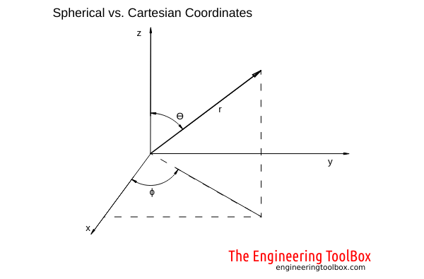

Spherical Coordinates
spherical polar to cartesian coordinates
Conversion of Cartesian coordinates to polar coordinates can be expressed as
r = (x2 + y2 + z2)1/2                          (1)
tan(Φ) = y / x                        (1a)
cos(Φ) = z / r
           = z / (x2 + y2 + z2)1/2          (1b)
Conversion of polar coordinates to Cartesian coordinates can be expressed as
x = r cos(Φ) sin(θ)                     (2)
y = r sin(Φ) sin(θ)                      (2a)
z = r cos(θ)                             (2b)

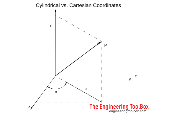

Cylindrical Coordinates
cylindrical to cartesian coordinates
Conversion of Cartesian coordinates to cylindrical coordinates for a point P can be expressed as
ρ = (x2 + y2)1/2                    (3)
tan(Φ) = y / x                     (3a)
z = z                      (3b)
Conversion of cylindrical coordinates to Cartesian coordinates can be expressed as
x = ρ cos(Φ)                        (4)
y = ρ sin(Φ)                        (4b)
z = z                        (4c)
