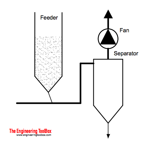

Negative Pressure Pneumatic Conveying System
Pneumatic transport conveying - negative pressure system

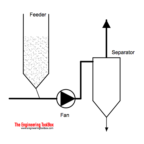

Positive Pressure Pneumatic Conveying System
Pneumatic transport conveying - positive pressure system

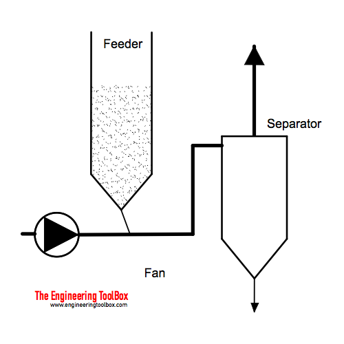

Combination Pressure Pneumatic Conveying System
Pneumatic transport conveying - combination pressure system
