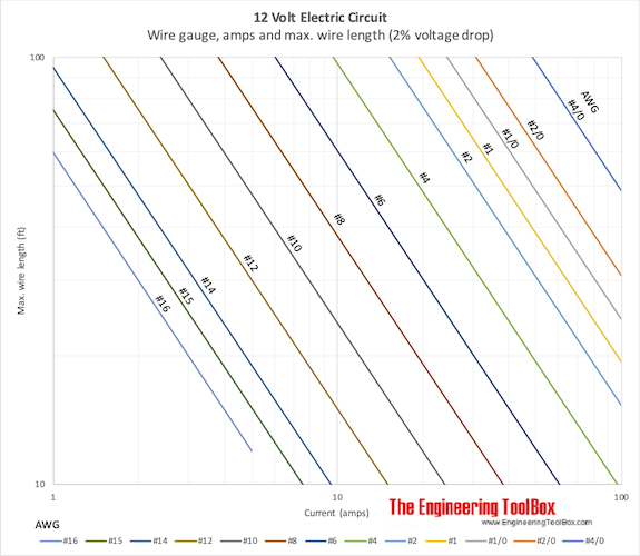

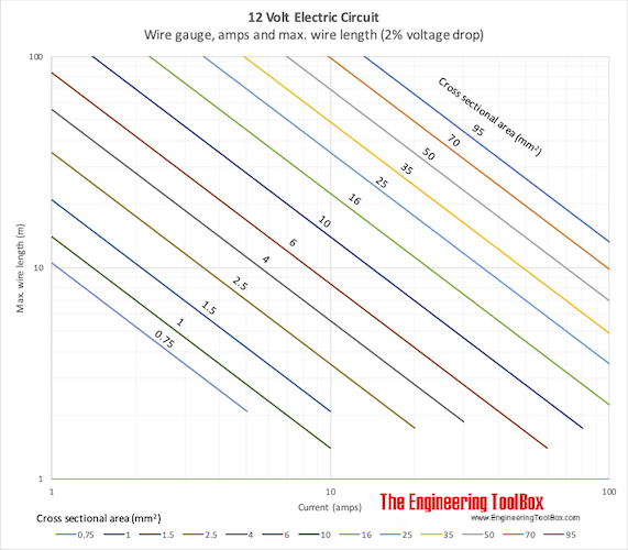

Maximum lengths for copper conductors from power source to loads in 12 volt systems with 2% voltage drop are indicated below:
Wire Length - feet
12 volt copper wire maximum length

Wire Length - meter

Example - Maximum Length of Wire
The current to a light bulb with power 50 W can be calculated with Ohm's law
I = P / U                  (1)
I = current (amps)
P = power (watts)
U = voltage (volts)
(1) with values
I = (50 W) / (12 V)
= 4.2 A
From the diagram above the maximum length of the total wire back and forth should not exceed approximately 8 m for gauge #10 (5.26 mm2) . By increasing the size of the wire to gauge #2 (33.6 mm2) the maximum length is limited to approximately 32 m .
Example - Calculate Maximum Wire Length
The electrical resistance in a copper conductor with cross sectional area 6 mm2 is 2.9×10-3 ohm/m . This is close to wire gauge 9.
In a 12V system with maximum 2% voltage drop - and current 10 amps - the maximum total length of the wire back and forth can be calculated with Ohm's law
U = R L I                (2)
R = electrical resistance (ohm/m)
L = length of wire (m)
(2) rearranged for L
L = U / (R I)                        (2b)
(2b) with values
L = (12 V) 0.02 / (( 2.9×10-3 ohm/m) (10 amps))
= 8.3 m
