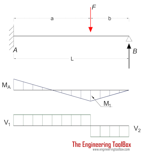

Beam Fixed at One End and Supported at the Other - Single Point Load
Beam fixed at one end and supported at the other - single point load Bending Moment
M A = - F a b (L + b) / (2 L2)                               (1a)
M A = moment at the fixed end (Nm, lbf ft)
F = load (N, lbf )
M F = R b b                               (1b)
M F = moment at point of load F (Nm, lbf ft)
R b = support load at support B (N, lbf )
Deflection
δ F = F a3 b2(3 L + b) / (12 L3 E I)                                  (1c)
δ F = deflection (m, ft)
E = Modulus of Elasticity (Pa (N/m2), N/mm2, psi)
I = Area Moment of Inertia (m4, mm4, in4 )
Support Reactions
R A = F b (3 L2- b2) / (2 L3 )                                 (1d)
R A = support force in A (N, lbf )
R B = F a2(b + 2 L ) / (2 L3 )                                 (1f)
R B = support force in B  (N, lbf )

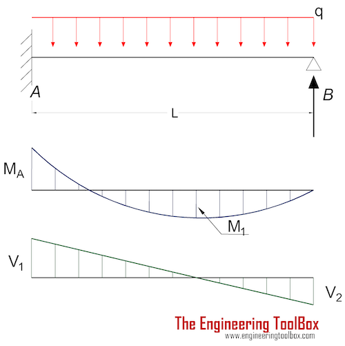

Beam Fixed at One End and Supported at the Other - Continuous Load
Beam fixed at one end and supported at the other - continous load Bending Moment
M A = - q L2/ 8                               (2a)
q = continuous load (N/m, lbf /ft)
M1 = 9 q L2/ 128                              (2b)
M1 = maximum moment at x = 0.625 L  (Nm, lbf ft)
Deflection
δ max = q L4 / (185 E I)                                  (2c)
δ max = max deflection at x = 0.579 L (m, ft)
δ 1/2 = q L4 / (192 E I)                                  (2d)
δ 1/2 = deflection at x = L / 2   (m, ft)
Support Reactions
R A = 5 q L / 8                            (2e)
R B = 3 q L / 8                            (2f)

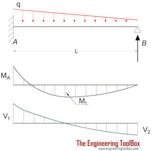

Beam Fixed at One End and Supported at the Other - Continuous Declining Load
Beam fixed at one end and supported at the other - continous declining load Bending Moment
M A = - q L2/ 15                               (3a)
q = continuous declining load (N/m, lbf /ft)
M1 = q L2/ 33.6                              (3b)
M1 = maximum moment at x = 0.553 L (Nm, lbf ft)
Deflection
δ max = q L4 / (419 E I)                                  (3c)
δ max = max deflection at x = 0.553 L   (m, ft)
δ 1/2 = q L4 / (427 E I)                                  (3d)
Support Reactions
R A = 2 q L / 5                            (3e)
R B = q L / 10                            (3f)

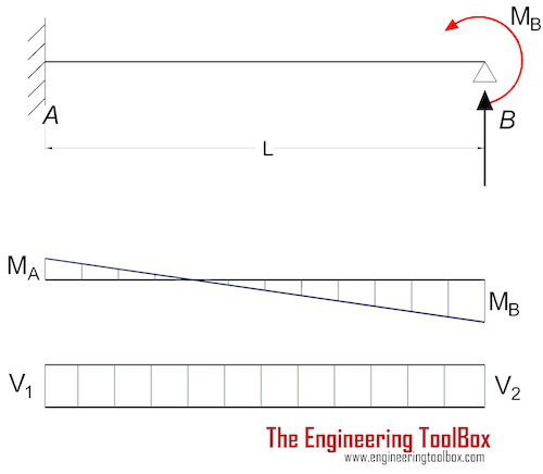

Beam Fixed at One End and Supported at the Other - Moment at Supported End
Beam fixed at one end and supported at the other - moment at the supported end Bending Moment
M A = -M B / 2                               (4a)
Deflection
δ max = M B L2/ (27 E I)                                  (4b)
δ max = max deflection at x = 2/3 L   (m, ft)
Support Reactions
R A = 3 M B / (2 L)                            (4c)
R B = - 3 M B / (2 L)                       (4d)
