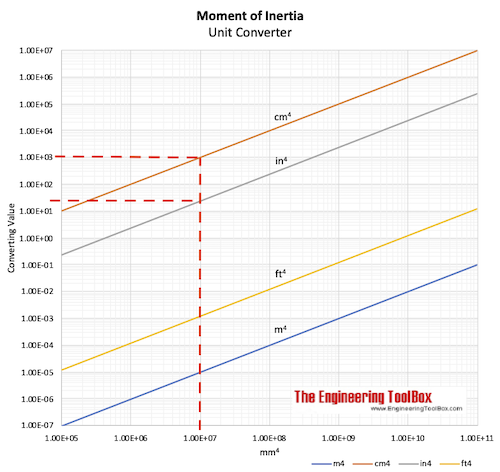

Moment of Inertia - Unit Converter Chart
Moment of Inertia - Unit Converting chart
Download and print Moment of Inertia - Unit Converting Chart
Moment of Inertia - Unit Converting Chart Example
100 cm4 (1.00E+02 cm4) can be converted to 10000000 mm4  (1.00E+07 mm4) or 24 in4 (2.4E+01 in4) as indicated in the chart below:
Moment opf Inertia Converter Chart Example
