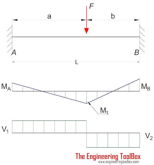

Beam Fixed at Both Ends - Single Point Load
Beam fixed at both ends - single point load Bending Moment
M A = - F a b2/ L2(1a)
M A = moment at the fixed end A (Nm, lbf ft)
F = load (N, lbf )
M B = - F a2b / L2(1b)
M B = moment at the fixed end B (Nm, lbf ft)
M F = 2 F a2b2/ L3 (1c)
M F = moment at the point load (Nm, lbf ft)
Deflection
δ F = F a3 b3 / (3 L3 E I)                                  (1d)
δ F = deflection at point load (m, ft)
E = Modulus of Elasticity (Pa (N/m2), N/mm2, psi)
I = Area Moment of Inertia (m4, mm4, in4 )
Support Reactions
R A = F (3 a + b) b2/ L3 (1f)
R A = support force at fixed end A (N, lbf )
R B = F (a + 3 b) a2/ L3 (1g)
R B = support force at fixed end B  (N, lbf )

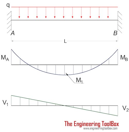

Beam Fixed at Both Ends - Uniform Continuous Distributed Load
Beam fixed at both ends - uniform load Bending Moment
M A = M B
= - q L2/ 12                                   (2a)
M = moments at the fixed ends  (Nm, lbf ft)
q = uniform load (N/m, lbf /ft)
M1 = q L2/ 24                         (2b)
M1 = moment at the center (Nm, lbf ft)
Deflection
δ max = q L4 / (384 E I)                                  (2c)
δ max = max deflection at center (m, ft)
Support Reactions
R A = R B
=  q L / 2                               (2d)
R = support forces at the fixed ends  (N, lbf )

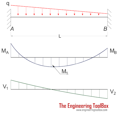

Beam Fixed at Both Ends - Uniform Declining Distributed Load
Beam fixed at both ends - uniform declining load Bending Moment
M A = - q L2/ 20                                  (3a)
M A = moments at the fixed end A  (Nm, lbf ft)
q = uniform declining load (N/m, lbf /ft)
M B = - q L2/ 30                                 (3b)
M B = moments at the fixed end B  (Nm, lbf ft)
M1 = q L2/ 46.6                         (3c)
M1 = moment at x = 0.475 L (Nm, lbf ft)
Deflection
δ max = q L4 / (764 E I)                                  (3d)
δ max = max deflection at x = 0.475 L (m, ft)
δ 1/2 = q L4 / (768 E I)                                  (3e)
δ 1/2 = deflection at x = 0.5 L (m, ft)
Support Reactions
R A = 7 q L / 20                               (3f)
R A = support force at the fixed end A  (N, lbf )
R B =  3 q L / 20                               (3g)
R B = support force at the fixed end B  (N, lbf )

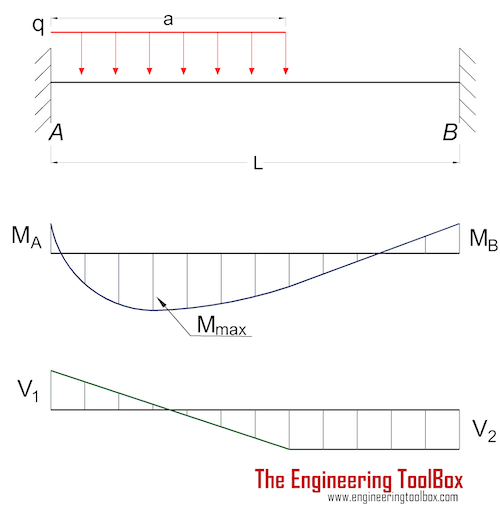

Beam Fixed at Both Ends - Partly Uniform Continuous Distributed Load
Beam fixed at both ends - partly uniform load Bending Moment
M A = - (q a2/ 6) (3 - 4 a / l + 1.5 (a / L)2)                                  (4a)
q = partly uniform load (N/m, lbf /ft)
M B = - (q a2/ 3) (a / L - 0.75 (a / L)2)                                 (4b)
Support Reactions
R A = q a (L - 0.5 a) / L - (M A - M B ) / L                              (4c)
R B =  q a2/ (2 L) + (M A - M B ) / L                              (4d)
