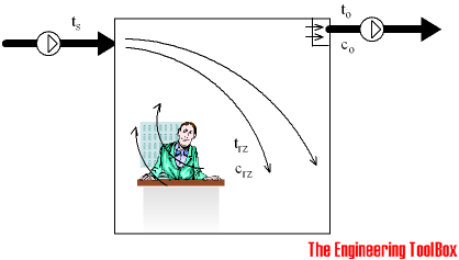

Temperature Efficiency
Temperature efficiency of a ventilation system can be calculated as
μt = (to - ts) / (trz - ts)                      (1)
μt = temperature efficiency
to = outlet air temperature (oC, oF)
ts = supply air temperature (oC, oF)
trz = room temperature in the residence zone - mean value (oC, oF)
The potential efficiency of a system depends on the ventilation principle used.
Short Cut Ventilation
With "short cuts" the outlet temperature is close to the supply temperature and the ventilation efficiency approaches to  zero.
Mixed Ventilation
With mixed ventilation the outlet temperature is close to the room temperature in the residential zone and the ventilation efficiency approaches to one.
Displacement Ventilation
With displacement ventilation the outlet temperature is higher than the temperature in the residence zone and in the supply air. The ventilation efficiency is higher (often much higher depending on the actual conditions) than one.
Piston Ventilation
Piston ventilation is an extreme variant of displacement ventilation. The efficiency is always higher than one.
