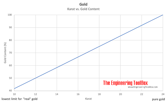

Gold - Karat vs. Gold Content in percent
Download and print Karat vs. Pure Gold Content Chart
