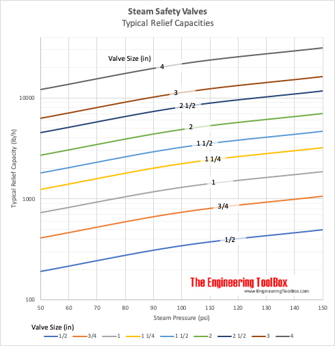

The size of a safety valve depends primarily on the maximum boiler output and the operation pressure of the system. The safety valve must as minimum have the evacuation capacity of all the vapor the boiler can produce running at full power at the working (or certification) pressure.
  • for a higher pressure the steam is compressed and requires less volume and the size of the valve can be reduced
  • for a lower pressure the steam is expanded and requires more volume and the size of the valve is increased
The tables below can be used to select a typical safety valve in a high pressure system. Before the final design - always consult manufacturing documentation.
Steam safety valves capacity chart
Steam Pressure 1000 kPa (10 bar) and 150 psi
High Pressure Steam Systems - Safety Valve Capacities - 10 bar

Note! The table above is based on steam with pressure 1000 kPa (10 bar) (or 150 psi in imperial units). Latent heat of saturated steam is 1999 kJ/kg (857 Btu/lb).
