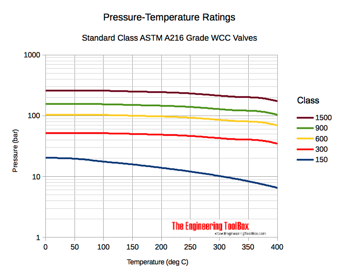

ASTM A216 Valves - Pressure Ratings vs. Temperature
Pressure and temperature ratings for cast carbon steel valves.
Pressure and temperature ratings for standard Class ASTM A216 Cast Carbon Steel Grade WCC Valves in accordance with ASME B16.34.
Metric Units
Valves - pressure temperature ratings astm a216 - in bar

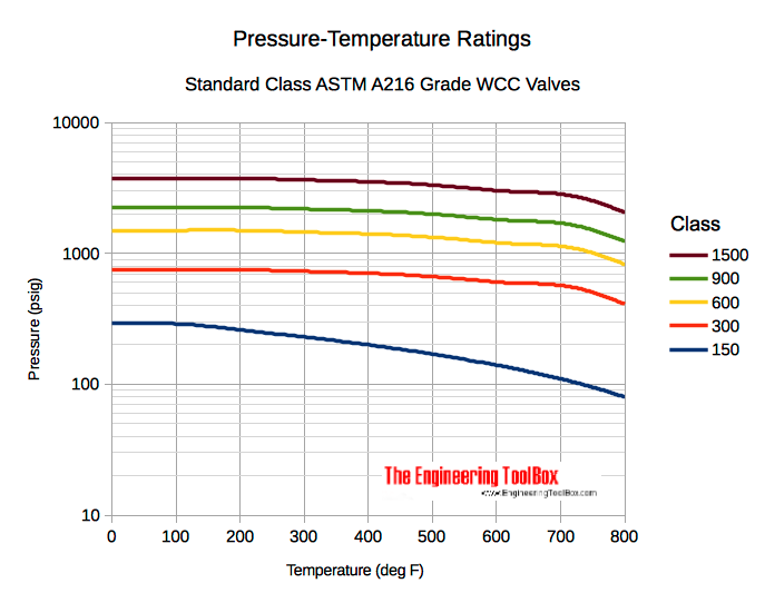

Imperial Units
Valves - pressure temperature ratings astm a216 - in psi
