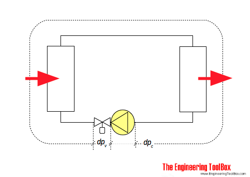

The valve authority expresses the ratio between pressure drop across the control valve compared to total pressure drop across the whole system.
Valve authority - pressure drop in circuit
Control valve authority can be expressed as
N = dpv / (dpv + dpc)                          (1)
N = valve authority
dpv = pressure drop across a full open control valve (psi, Pa, kPa, bar)
dpc = pressure drop across the circuit (psi, Pa, kPa, bar)

Example - Control Valve Authority in a Heating System
The total pressure drop in a heating system circuit at full load is 15 kPa. The volume flow is 1.4 l/s.
For decent control the valve authority is set to N = 0.8. The pressure drop across the control valve dpv can be calculated by transforming (1) to
dpv = N dpc / (1 - N)                     (1b)
- or with values
dpv = 0.8 (15 kPa)  / (1 - 0.8)
     = 60 kPa
The flow factor for the valve with volume flow 1.4 l/s can be estimated to approximately
Kv = 7
by using this flow factor diagram. For a Straight Through Diaphragm Valve of "Saunders" type this corresponds to a 15 mm valve.
