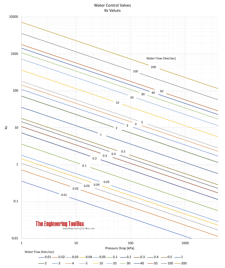

Water flow - Kv diagram chart
Example - Kv for a Water Control Valve
For a water control valve with
  • pressure drop 2 bar
  • water flow 1 kg/s
- the Kv value should be approximately 2.6 according the table above.
Kv can be calculated as:
Kv = q / (dp)1/2                     (1)
Kv = Kv value
q = water flow (m3/h)
dp = pressure drop (bar)
