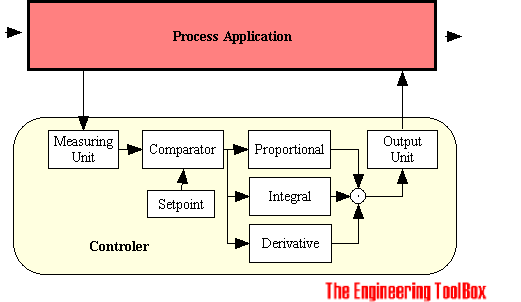

Basic Controller
The Basic Controller for an application can be visualized as
Process control loop
The controller consists of
  • a measuring unit with an appropriate instrument to measure the state of process, a temperature transmitter, pressure transmitter or similar
  • a input set point device to set the desired value
  • a comparator for comparing the measured value with the set point, calculating the difference or error between the two
  • a control unit to calculate the output magnitude and direction to compensate the deviation from the desired value
  • a output unit converting the output from the controller to physical action, a control valve, a motor or similar
