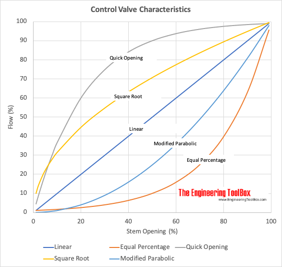

Inherent Control Valve Flow Characteristics
The most common characteristics are shown in the figure above. The percent of flow through the valve is plotted against valve stem position. The curves shown are typical of those available from valve manufacturers. These curves are based on constant pressure drop across the valve and are called inherent flow characteristics.
  • Linear - flow capacity increases linearly with valve travel.
  • Equal percentage - flow capacity increases exponentially with valve trim travel. Equal increments of valve travel produce equal percentage changes in the existing Cv.
  • A modified parabolic characteristic is approximately midway between linear and equal-percentage characteristics. It provides fine throttling at low flow capacity and approximately linear characteristics at higher flow capacity.
  • Quick opening provides large changes in flow for very small changes in lift. It usually has too high a valve gain for use in modulating control. So it is limited to on-off service, such as sequential operation in either batch or semi-continuous processes.
  • Hyperbolic
  • Square Root
The majority of control applications are with valves with linear, equal-percentage, or modified-flow characteristics.
