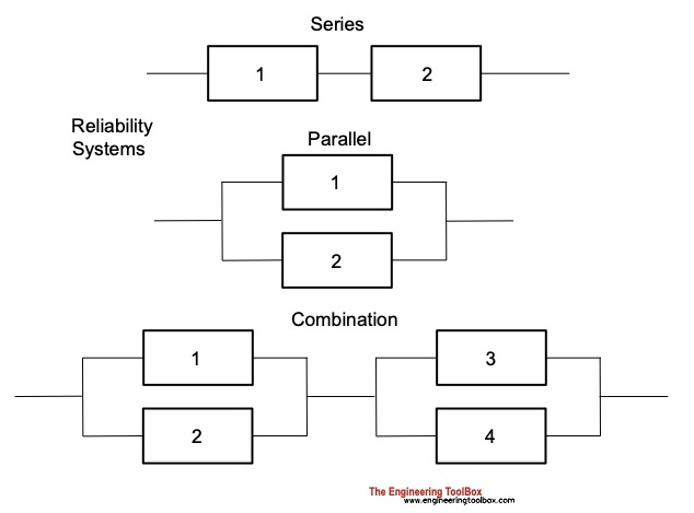

Systems Reliability
There are two basic types of reliability systems - series and parallel - and combinations of them.
  • in a series system - all devices in the system must work for the system to work
  • in a parallel system - the system works if at least one device in the system works
Reliability systems - series and parallel
Reliability of Systems in Series
Reliability of systems in series can be expressed as
Rs = R1 R2                        (9)
Rs = system reliability
R1,2 = subsystem reliability
Example - Reliability of Systems in Series
From the example above the reliability of a car over three year is 0.88. If we depends on two cars for a mission - whatever it is - the reliability for our mission will be
Rs = 0.88 0.88
    = 0.77
    = 77 %
Reliability of Systems in Parallel
Reliability of systems in parallel can be expressed as
Rs = R1 Q2 + R2 Q1 + R1 R2                       (10)
Q1,2 = (1 - R1,2) subsystem unreliability
Example - Reliability of Systems in Parallel
From the example above the reliability of a car over three year is 0.88. If it is enough with one of our two cars for our mission - the reliability for our mission can be calculated as
Rs = 0.88 (1- 0.88) + 0.88 (1- 0.88) + 0.88 0.88
    = 0.99
    = 99 %
Note! - two systems in parallel with 99 % reliability vs. one system alone with reliability 88 % shows the power of redundancy.
