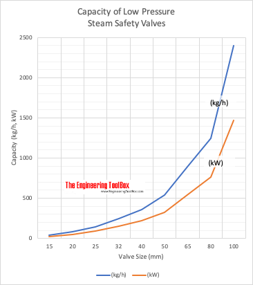

The size of the safety valve depends primarily on the maximum boiler output and the operation pressure of the system. The safety valve shall as minimum have the evacuation capacity of all the vapor the boiler can produce running at full power at working (or certification) pressure.
The table below can be used to select a typical safety valve based on boiler output. Before final design, always consult the manufactures documentation.

CapacityMaximum Boiler Output
(in)(mm)(kg/h)(lb/h)(kW)(Btu/h)
1/2 15 38 86 23 81 270
3/4 20 82 185 50 174 825
1 25 145 324 89 306 180
1 1/4 32 249 557 152 526 365
1 1/2 40 360 807 220 762 615
2 50 536 1 199 328 1 133 055
2 1/2 65 901 2 012 551 1 901 340
3 80 1 244 2 779 761 2 626 155
4 100 2 397 5 355 1 465 5 060 475
Note! The table above is based on low pressure steam of 100 kN/m2 (1 bar) or 15 psi in imperial units. Latent heat of saturated steam is 2201 kJ/kg (945 Btu/lb).

Capacity of low pressure steam safety valves chart
