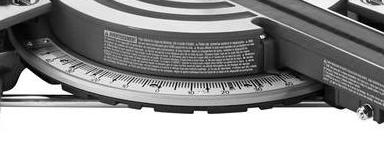

Miter saw protractor angle
The miter saw angles for cross cuts and decorative mouldings in corners or other locations can often be hard to measure correctly.

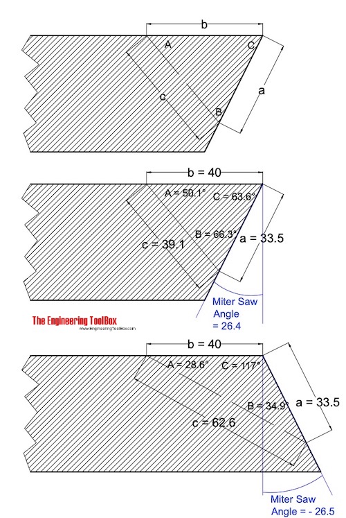

With this tool you measure the three lengths a, b and c as indicated in the drawing below. The miter saw cutting angles are easily calculated by inputting the values in the miter saw calculator below.

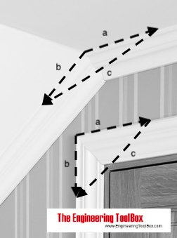

Tip! - Distance c can be difficult to measure in corners. It may be helpful to use a stick or something similar with a known length for c. Position the stick somewhere in the corner as indicated in the drawings below. Measure the lengths a and b from the bottom of the corner to the ends of the stick.
Skirting panel decorative moulding miter saw angle cut calculation
Examples - Miter Saw Angle Calculator
The first example below with the default values used in the calculator above calculates the miter saw angle to 26.4 degrees for length a = 33.5, b = 40 and c = 39.1.
Miter saw angle calculation
The second example calculates the miter saw angle to -26.5 degrees (miter saw opposite side compared to the first example) for lengths a = 33.5, b = 4 and c = 62.6.
